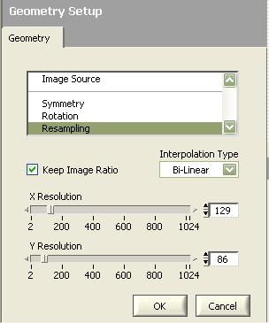

after getting the image you can resample it. In vision assistant go to images-->image geometry-->resampling
