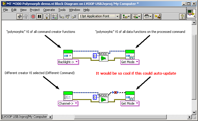

Going back to your original image from the Idea Exchange, what is the role of the "Get Mode" poly VI in this set up? Is it returning the Event refnum? And thus for "Open FP", it would return only one refnum for a parent class but two refnums for the child class?

The other idea I was actually trying to approach was as follows:
I have a process which controls access to some resource (M300 in the original image).  This accepts a set (expandable) of message objects which are then used in conjunction with the resource to perform a specific task.  Due to "Preserve run-time class" the input object is correctly mirrorred on the output side.
Since the message objects have their own inheritance hierarchy, I was annoyed by the fact that changing the method object upstream of M300 caused the accessor VIs I had designed for the previous message object caused the polymorphic VI downstream of M300 to break the wire because the polymorphic VIs must have different names.  I was looking for a kind of "Dynamic Dispatch Polymorphic VI" to automatically update the polymorphic VI with my entire API when changing the upstream object type.
Using property nodes essentially allows this functionality.  The (kind of undocumented) ability to create submenus in propertynode hierarchies makes this essentially already implemented.  The further requirements I already outlined above were mistakenly thought to be an integral part of the idea, but it turned out they were actually distinct.
