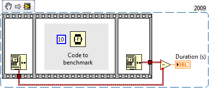

How do you write code to actually benchmark something? The classic way is to use a three–frame flat sequence and put timestamp generators in first and last frames with the code to be benchmarked in the center. Common methods use the millisecond timer, time/date in seconds, or calls to the Windows high performance counter. The time/date in seconds version is shown below. Note that this method has microsecond resolution on OS X and Linux, since both use the high performance timer under the hood. Windows, unfortunately, requires calls into system DLLs to get the same performance (see attached code for examples). Time/date in seconds has millisecond resolution on Windows.

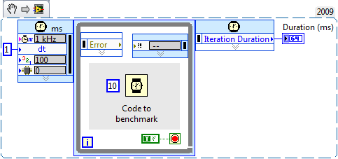

An alternate method for timing is to use the timed loop. In using the timed loop, the output is in clock ticks. The clock source is set on the input. Real time and FPGA systems have far more options than desktop systems. I saw this method recently on these forums, but was unable to find it again. My thanks to whoever posted it, and apologies for not properly attributing it. Note that on Windows, the input timing source will limit you to millisecond resolution.

Of course, ten minutes after I post, I find the originator of the timed loop method of benchmarking.  It was posted by tst in this community nugget.
To save people some time, I assume you're refering to this. I don't remember exactly how I came up with the idea (I think it just came to me one day), but unfortunately I can say that it only happened AFTER I wrote some scripting code to generate the wrapper automatically. Smiley Sad
