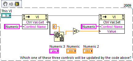

My least favorite thing about the Set Control Value method is that it creates fragile code. You must type the control name perfectly to match the label (one of the very few text-based language SNAFUs inserted into LabVIEW's graphical programming). Also, if you change the label of a terminal in a subVI without remembering to change the string into the Set Control Value, you have broken your code without knowing it (run-time failure, versus being able to catch the error compile time).
Finally, for whatever reason, LabVIEW allows terminals - even terminals of the same type - to have the same label. Even empty labels are allowed. This creates an ambiguous scenario where it's indeterminable which control value will be changed by the method (well, I think the control created first is the one to change, but there's no straightforward method for determining which control was created first).
The one scenario where Set Control Value is arguably the best method to pass data is when making Fire-and-Forget dynamic calls. That's why I'm a huge proponent of this Idea, which would all but deprecate the Set Control Val method.

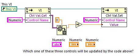

Wow! The snippet renames my controls to be properly unique! Well, here's a screenshot of what I'm looking at. If you test that snippet code, rename all controls to "Numeric" prior to running. And also, change the "This VI" control into a ref constant.

Why couldn't a method in LabVIEW] be developed that works asynchronously, like Ctrl Value Get or Set, but the actual control is defined using a Reference so the code isn't so fragile?
I guess as it is now, you could feed a reference to a property node to get its label, then feed that to the Ctrl Value Get or Set.
And to answer Jack's question, I am going to guess that whichever control named "numeric" that LabVIEW detects first is the one getting updated.  Whether that is the first is some stack of references, the first created, the last created.  Maybe the even the one that has either the highest or lowest Z value on the front panel.  I really don't know.  And will whichever is first in a given instance of LabVIEW, will it be first again, or could some recompile reshuffle the controls.
According to the detailed help, the method uses the tabbing order of the front panel objects to locate the control.
