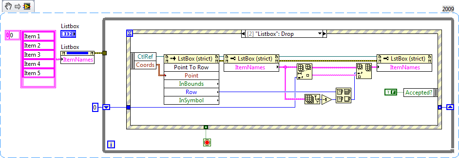

I am trying to use dag and drop on a listbox. I have it set to move only and it works fine. The problem is that if I have a drop event the item moved just goes away. I could not find any examples or answers in the forums.

If you right click the listbox to access the properties you will find under drag and drop >> drag mode you have it set for move only.
If the item is going to be "moved" then it will be deleted from the list when the drag operation is completed -- this is probably what you want.
However you have to manually add the item back into the list if you accept the drag operation.  You can find a decent example here:

Thanks. The listbox behaves just like I want it to unless I add the drop event. I will have to figure out how to insert the items to the dropped position. It really isn't straightforward is it.

It is not unstraightforward.  Shift register holds the listbox value at the time of drag start (ie. the index of the item).
