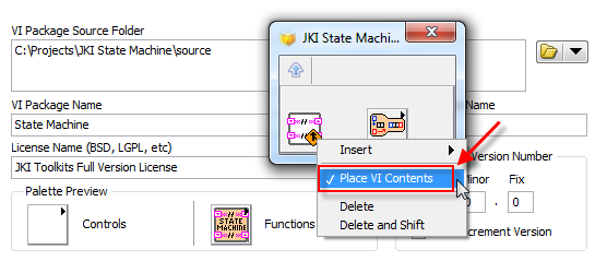

It's been mentioned that this is the Merge VI palette setting for the VI.  We actually use VIPM Professional to build the JKI State Machine package.  VIPM has a palette setting called "Place VI Contents" and indicates this setting in the palette editor using the "merge" (3-5-2010 9-06-09 AM.png) icon, shown below:
-Jim
