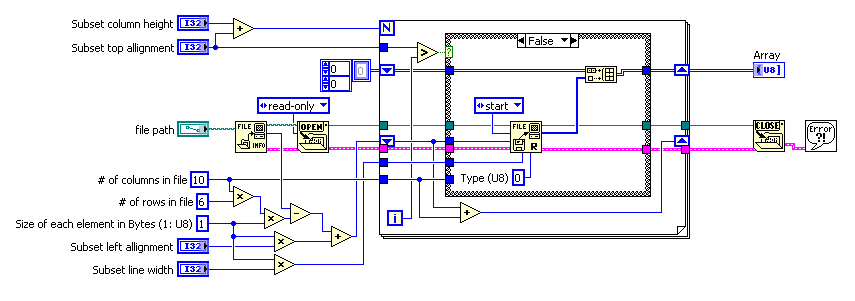

Hmmm, well if you simply can't afford loading the complete bitmap first and then perform the subset function there's one other possible solution - although very speculative and most likely not very efficient - that will only load the necessary amount of subset data. The method is to load one line at a time from the bitmap file. By calculating where each of YOUR lines begin in the bitmap file and knowing the size of each of YOUR lines, you can simply read one line at a time from the file and then build the 2D array from all the separate lines.

My example only reads exactly the data/subset that you request. It reads line by line of the subset and then builds these lines into a 2D-array. Therefore you don't have to be concerned about reading the complete file into memory. Notice that the lines in the subset doesn't "wrap" to the next line, as they did in your original example. Just to be really nice, I have also attached the actual VI (LoadSubsetOnly.vi).

Hi Phillip:
I slightly modified your LoadSubset.vi to use the replace array element to avoid on-the-fly memory allocation.
Your VI works pretty good on a desktop computer.
However, I'm saddened to report its insufficient when running under LV7.1 PocketPC2003 edition. Even in the documentation NI states to avoid a lot of loop iterations when writing programs for the PDA.
In my case, my loop counter is set to 261 iterations and the IPAQ H5555 with 624 MHz processor takes more than 6 seconds to go through the loop read.
Thats too bad.
If there was one call to the read.vi in order to control how to load a 2D array, I would have a streamlined app. But for now, I'll just have to load my whole image into the application.
Hopefully, in LV8.0 there will be more control when loading 2D binary arrays.

But than you still have the speed limitation issue. For PDA development, putting the Read.VI in a loop as shown in the previous bitmap, yields load times of over 6 seconds for ~260 iterations. This is not good is you want to scroll the map and display only a sub-section of the map to condserve memory. Your method still needs to call the Read.VI multiple times in a loop.
