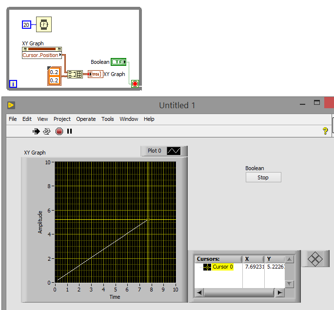

Hi Zonda,
read the cursor position, add one more point (your "fixed point") to create a plot in your XY graph:

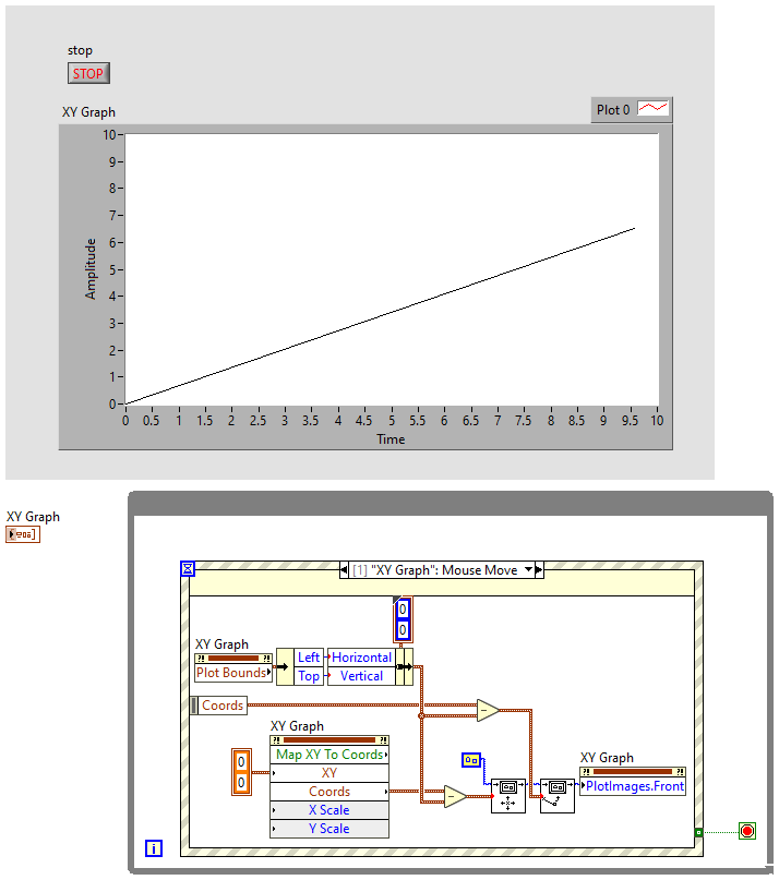

It depends if you mean by cursor "mouse cursor". You can draw a line based on the mouse coordinates without using the graph cursors. You simply use the corresponding event from the XY graph in an event structure and draw on one of the picture plane of the graph (I selected front) along with the proper invoke node to convert from XY graph to mouse coordinates. Below is an example using the "Mouse move" event and (0,0) as the fixed point. VI is attached in LabVIEW 2016.
Marc Dubois
Message 4 of 9
(4,448 Views)

Something like this:
Tim
GHSP

Hi Tim,
Please can you attach the VI file of that image.
Thank you
Message 7 of 9
(4,424 Views)
it is a snippet. You can drag it into your block diagram. Save it to your desktop and drop it on your block diagram.
Tim

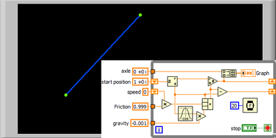

Maybe something a little simpler ... Make sure you understand every single part.
Message 9 of 9
