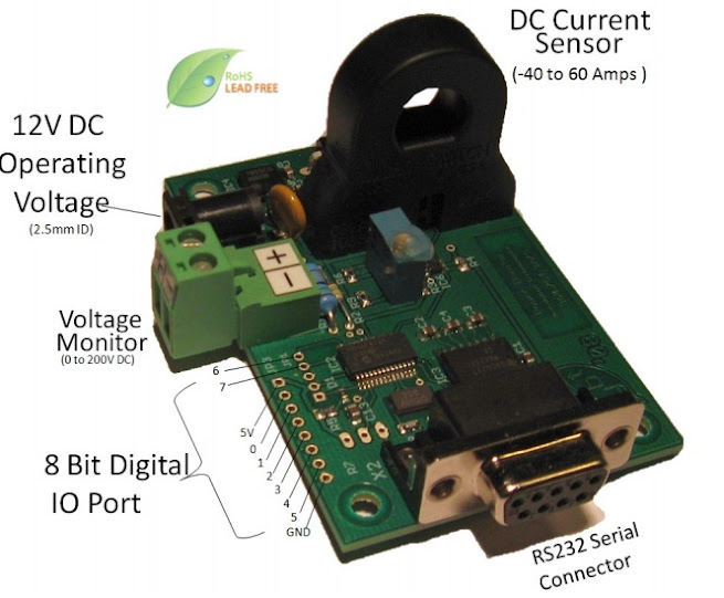

I'm currently building a bike generator that would have the ability to power LEDs (based on whatever power is output). The LEDs would look like it's scrolling. While doing some testing, it appeared that the maximum power obtained while pedalling the bike was about 3 W. Connected to the generator is a serial power monitor called WattsView, which is a circuit that contains a loop that measures amps using the hall effect. This circuit collects data of volts and amps, sends it the software it went with onto the computer, and I am also able to view power (calculated).

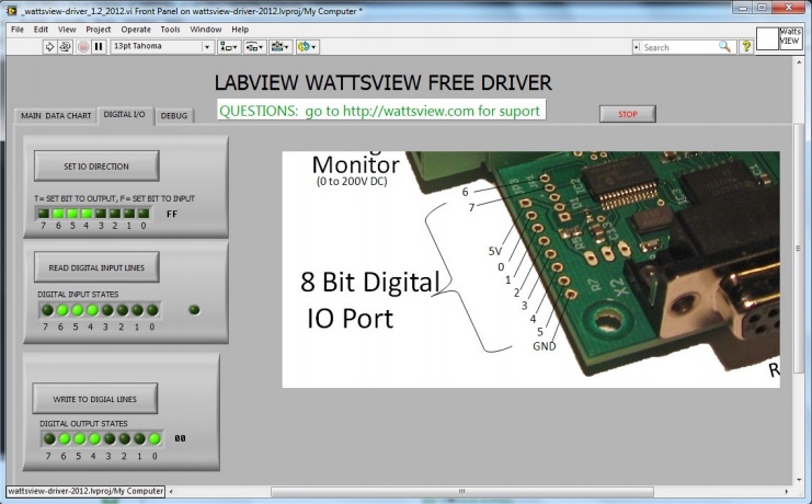

On the WattsView circuit, an 8-bit Digital I/O is also included, which operates from 0 to 5 Volts DC. Below is a picture of how WattsView looks like. On the WattsView website, a free LabVIEW driver is also included. Below is also a screenshot of the program.

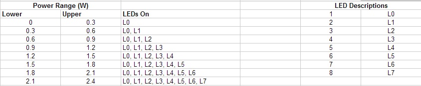

I currently do not have access to LabVIEW (it's on my work computer), so I will post other screenshots later. However, below is a table of what I would like to do with the 8-Bit Digital IO Port.
Basically, I would like to have each LED turn on when it reaches +0.3 W. Currently, my idea of doing it would be to create a constant from the power indicator of the LabVIEW program. I will then use the In Range & Coerce Function to set the upper and lower limits for the power range (using the power constants).
Upper limit: 0 W
Lower limit: 2.4 W
The In Range output will then be connected to the selector terminal of the case structure. So when:
In Range Output = 1: Execute equation to turn on necessary LEDs
In Range Output = 0: Do nothing
At this point, I have no idea where to go, particularly with the case for when In Range Output = 1. I was thinking of doing a bunch of nested case structures within this case for the different ranges. However, I don't know how I would do it so that the LEDs would scroll up when power increases, and scrolls down when power decreases. Any light of this situation? Any tips or advice is greatly appreciated.

ake your power.  Use Quotient/ Reminder to divide by 0.3.  Use the quotient output to add 1.  That will tell you how many LED's to turn on.  Use In Range and Coerce to coerce the value to be 8 or less .  (Since 2.4 divided by .3 is quotient 8.  Adding 1 makes it 9).   Call this value X.
I would then use that value to initialize an array of that many (X) True booleans.  Append it to an array of (8-X) False booleans.

Below is a screenshot of the entire LabVIEW WattsView Driver (Block Diagram)
Circled in red is the data of volts and amps that is being collected from the WattsView circuit connected to the generator. Double clicking this icon for "4 Mat Data" opens the following Front Panel:
I opened the block diagram for this VI, and below is how it looked liked. Circuled in red, I determind this is where the output of power is, for P = V*I. Therefore, I created an indicator for the power to display the values on this VIs Front Panel.
I copied the Power indicator onto the main LabVIEW Driver Program, and below is how it now looks like:
I am unable to connect the Power indicator to the input of the Quotient and Remainder Function. This function accepts a double 64-bit, which is the data type of the Power indicator. Now I'm lost. How do I make this Power as the proper input into this function? And how would I go about inputting a constant valu of 0.3 into the second input of the function?
