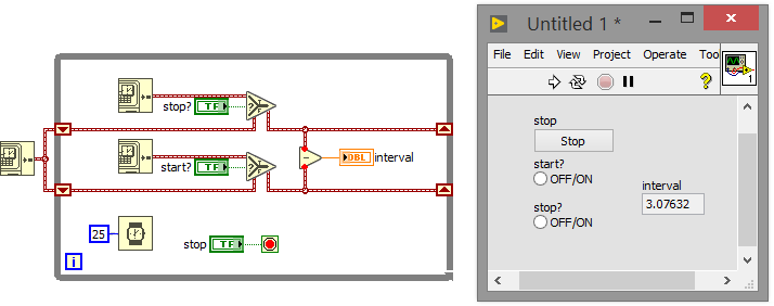

Hi Josh,
you really should take those Training resource to learn LabVIEW!
Just to give an idea:
(All buttons set to latching switch mode…)
