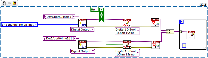

I'm wondering whether you select all needed channels for the task you create. You can try to create separate tasks also, for example, with needed lines groups, like here:
(3,866 Views)

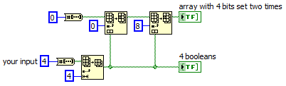

Hi Dave,
a very simple (and not optimized) way:
Create your 4 booleans for the first 4 lines in the port and set them twice in a boolean array for the whole port.
When you want to optimize this you only need to use integer numbers and some simple math…
(3,830 Views)
Done - thanks GerdW!
I set up a task using the whole port and then ran your snippet in a loop for each of the U32 addresses I need to call. Then I converted the Boolean array back to a U32 number for each, then used DAQmx Write with U32, 1 Chan NSamp to write the integer array.
