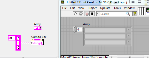

YOu see this behavior because of a LabVIEW rule of arrays:
An ARRAY is an ordered collection of IDENTICAL elements.
The data may be different among elements in the array, but the PROPERTIES must be the same.
To prove it, open an array of something on the front panel and show 3 elements.
Paint the first element blue.  Notice how they all turn blue?
Change the 3rd one to 23 point italic.  Notice how they all change?
In reality, there is only one element, and LabVIEW does some trickery to duplicate it so you see multiple data items.  But when you set the PROPERTIES of some element in the array, you are setting the properties of the one and only element, and they all fall in line.
And the STRINGS of a combo box is a property.

Coastal, this isn't true.
Sure, it's true - try it yourself:
Run this program and the lists of ALL THREE combo boxes (plus any more you care to reveal in the future) are set to A, B, C.
That's because under the hood there is really only one set of properties.
