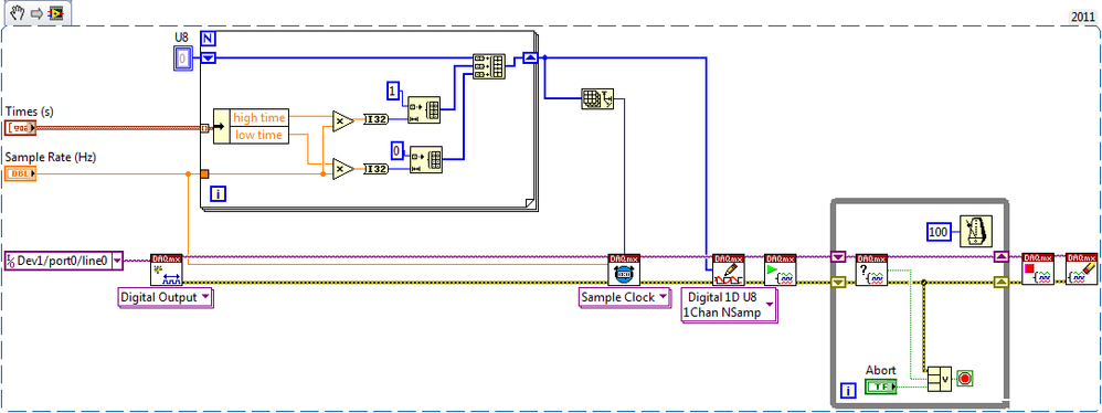

The 6132 counters can't do what you are asking.  Using this hardware you would need to build the appropriate digital output array based on your desired times and use a buffered digital output task:

There are a few downsides to using the digital output method that may or not be an issue for your application:
1.  It requires a much larger buffer (1 byte per sample compared to 8 bytes per period).  If you need high timing resolution and need to output a long sequence of pulses you might not be able to write the entire buffer at once.
2.  More data needs to be streamed across the bus (also 1 byte per sample compared to 8 bytes per period).  Might be an issue if you are running concurrently with other streaming applications.
3.  Less timing resolution (10 MHz max output frequency on the 6132 compared to 100 MHz counter output timebase on an X Series).

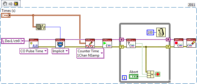

When I first discovered the buffered output on counters I was so excited I made a frequency/duty cycle sweep using one.
https://forums.ni.com/t5/Example-Code/Frequency-Sweep-Counter-Output-with-DAQmx/ta-p/3517936
That was using the built in PFI0 on a cDAQ-9188 but works on other counters.

Hello John,
I was able to generate the pulses using the vi you posted above. The only change in the vi I had to make was to give the timebase input to DAQmx Timing block. I was able to modify the vi to get the input from spreadsheet.
