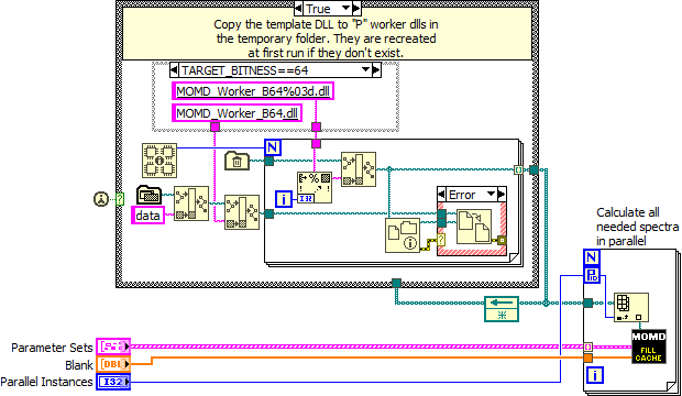

That's exactly what I do here. My fortran dll cannot run multiple instances, so when the program starts up, it will create N (matched to the number of CPU cores) unique copies in %TEMP%, then call them using the parallel instance ID by name. Works great!
Sorry, posting by phone. Can show some template code later. I even use a conditional disable structure to select 32 or 64 bit dll version, depending on LabVIEW bitness.

Just FYI, here's a simplified version of the code I use. The master DLLs (32bit&64bit) are located in the data folder of the built application (and same relative path in the dev environment, of course). Paths are cached in a feedback node for further calls. The P terminal of the FOR loop needs to be configured to output the parallel instance ID.

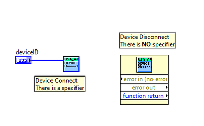

There is a Device Connect that specifies a particular instrument. All other calls have no specifiers, even Device Disconnect. The API kind of stinks. My guess is, you specify an instrument in the beginning and that is it; everything else defaults to that instrument.
