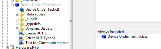

It coulld be a matter of how you are including your class. For example:
Here I have added just the class, but you can see that while the class was added to "Always Include", nothing in the class was added.
Mike...
BTW:  LVLIBs do the same thing -- and don't ask me what kind of sense this makes...
