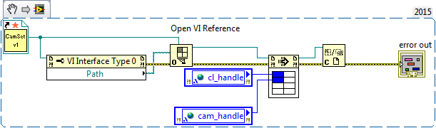

Well, you are still being "stingy" with your code -- the tidbits you deign to show us are missing so many pieces that the MainTest has broken arrows due to missing VIs.
I cannot "see" the problem you are having, but I can illustrate a variation on your code that Hooovahh was describing.  Here is the Call-by-Reference code in MainTest using a Static VI Reference (I gave CamSetV1 an Icon, both because every VI you write should have an Icon, and because it helps make LabVIEW code self-documenting).
Several things note, here.
  • The "Red Star" in the Static VI Reference is because I right-clicked and made it a Strictly-Typed Reference, needed for Open VI Reference to get the connector pane right.
  • By using the Path Property of the Static Reference, the code doesn't have to worry about the path.  Great when building Executables!
  • If you are using Start Asynchronous Calls, you'll need to set the Option parameter on Open VI Ref to 0x80 or 0x100.
Bob Schor

Hello , I gave the option field as 0x80 and everything worked fine. But I got an error code 1000. The VI is not in a state compatible with this Operation. What does that mean.
Message 26 of 28
(2,504 Views)
That means whatever you tried to just do is not allowed at that moment.  Like trying to run a VI that is already running.  What method or property generated that error and what state was the VI in when it was generated?
Message 27 of 28
(2,492 Views)
Got it working. The assynchronous call run the VI. There is no need for another RUN VI. Kudos to all. I am attaching the final working solution.
