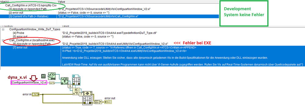

the code above is a reference to the  dyna_x.vi .
The probes show the result in Development & EXE.

Seems to me the path is wrong.
VI paths change in executables. It will include the executable as folder...
Put a Message Box in the code, showing the VI path converted to string. Make sure it is correct. I think it's not. The wrong path is shown in the probe. Note the executable name in the path...
"c:\source code\my sub vi.vi" will turn into "c:\builds\my executable\my sub vi.vi", and you use this path to make the dynamic path...

You probably want to use the 'Application Folder' function (q.v.) to locate the dynamic VI.

used Application Folder VI, does not help.
Put a indicator or a MessageBox in your application so you can examine the path that is used.
See how it is wrong, and what is needed to fix it..
Do you get the same error? Even if the new path is correct, there could be a new error that could be completely unrelated. Maybe even more errors when you fix that one as well...
