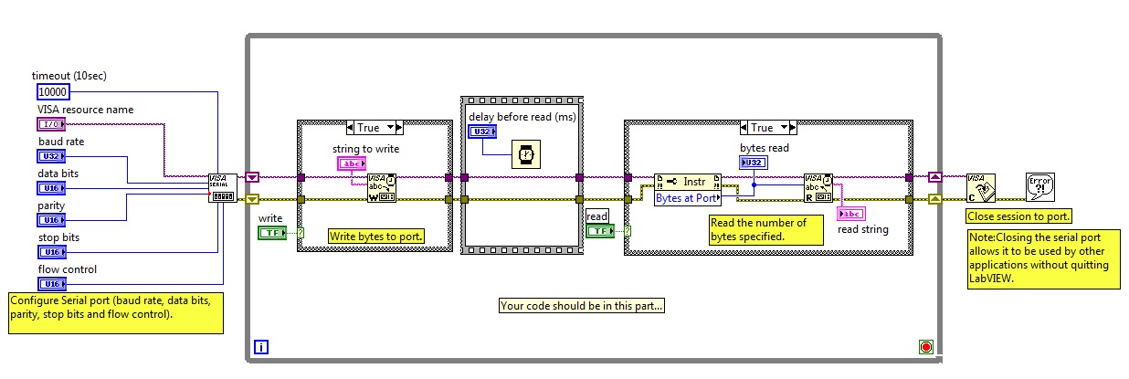

Hi Beachard!
Here is an example of what I mean about taking out of the loops the VISA references (Configure serial port and Close), this is a very recommended practice because by this way you ensure that you don’t open and close the references in the same node in which your code resides. Also note the delay before reading the port; you should always give some time to the port before you start reading the 1st byte of data in order to avoid errors like – 1073807253.
Hope this helps!
Luis Castaneda
Ingeniería de Aplicaciones
www.ni.com/soporte
Luis CT
