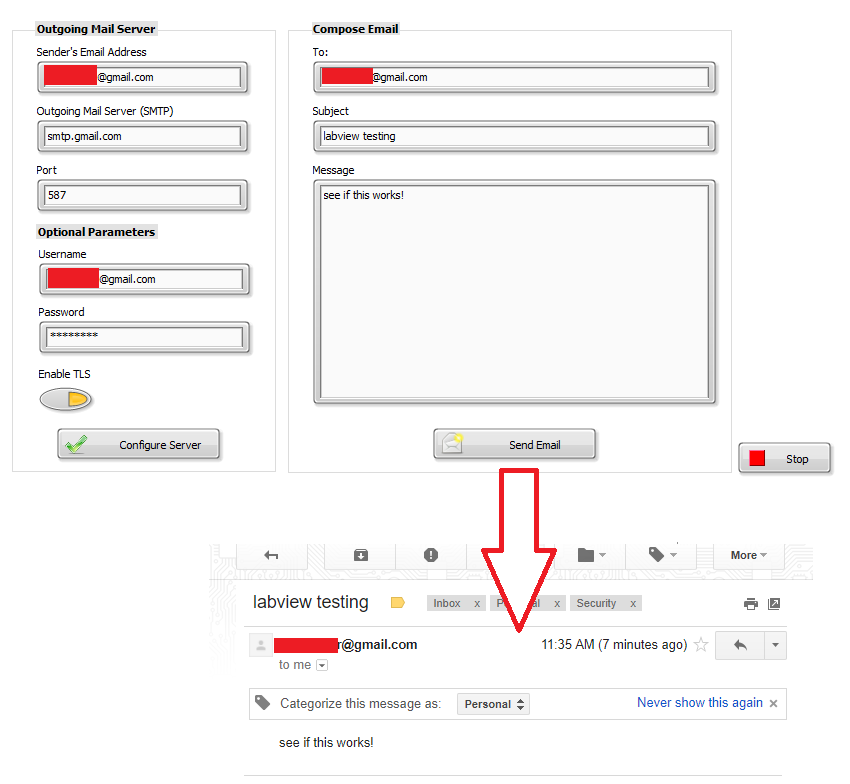

@Cham35 wrote:
Same problem with me...
What is your LabVIEW version?
As a fist step, try using the shipping example "Send email using SMTP client". I just tested and it still works fine for me (port 587, less secure, TLS enabled). Make sure to press "configure server" before pressing "send e-mail".
(Also make sure that you enable less secure application for the sender account (ht.plate.klimalab@gmail.com) e.g. the setting for the recipient account is irelevant. I am sure you did it right, just trying to cover all bases).

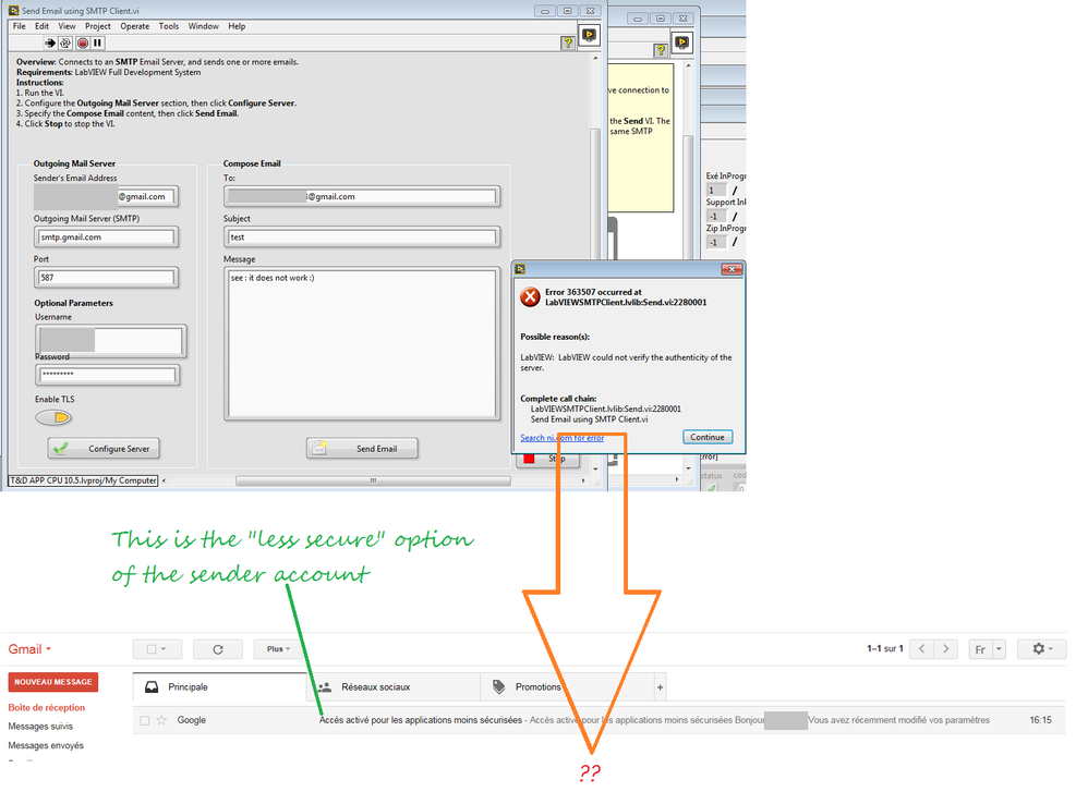

For me and (my LabVIEW 2015 SP1 f7) and my gmail address created yesterday, this does not work.
I also set up my Gmail account by removing the two-step validation of the connection (second step is SMS on phone number).
I think there is other(s) security issue, like :
> https://support.google.com/a/answer/176600? : how we can fill a CAPTCHA in LabVIEW Smiley Wink (I found a page that unlock Captcha with no more success !(https://accounts.google.com/DisplayUnlockCaptcha , found this on the help in the trouble shoot section : https://myaccount.google.com/permissions)image.png
> Is there a need to use the "Gmail API Client Library for .NET" ? (https://developers.google.com/api-client-library/dotnet/apis/gmail/v1)
> or an authentication and authorization issue like they describe to use Google API ? (https://developers.google.com/api-client-library/dotnet/get_started)
> or the use of the Gmail API : https://developers.google.com/gmail/api/guides/sending ?
> or maybe it depends on the internet provider or other ? (even if I shut of firewall there is no email sended)
Thank ! (and sorry for my poor English, I'm frenchy 🙂
