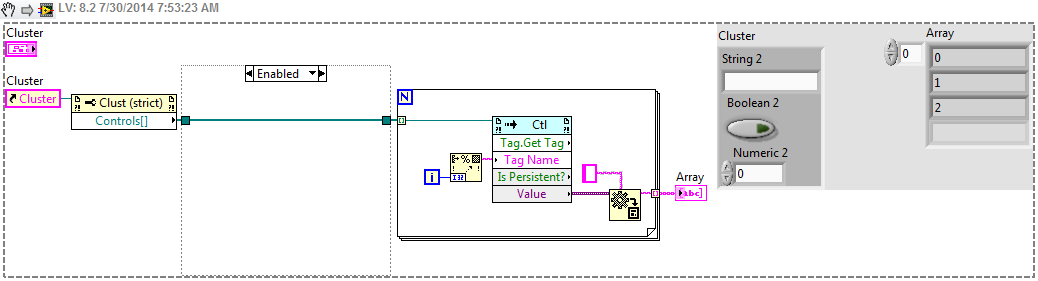

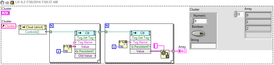

You might be able to "tag" a control and find it by that.
First run:
Change names and order of controls in cluster (and disable the tag-setting loop):
I still got the same tag values for the controls with the original tag names.  Name and order don't matter any more.
