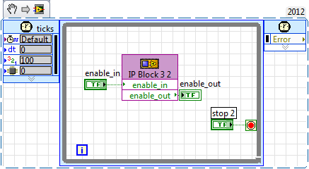

I know this fact. I too have very limited knowledge of VHDL. Anyways can you just post me the code plus VI?. And thank you for your cooperation, really appreciate it 🙂
Message 12 of 13
(916 Views)
Accepted by topic author NapDynamite
You're welcome, but the VHDL code I used is back in Post #9, and my VI is not going to do you any good, as the IP Integration Node didn't exist back in LabVIEW 8.6 - just the HDL Integration node did. But here it goes anyway. I also attached the simulation files.
Remember to mark the question as solved and give the appropriate kudos 😉
