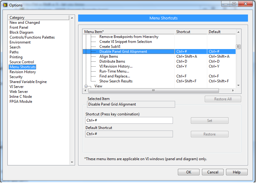

Hi Puneet,
If you go to Tools>>Options>>Menu Shortcuts and look for Enable Panel Grid Alignment, what does it say for the menu shortcut?
I just tested this and by default Ctrl+# does disable the Panel Grid Alignment in both LabVIEW 2010 and 2011.

Hi Jeff,
Its Ctrl+# as shown in screenshot.
