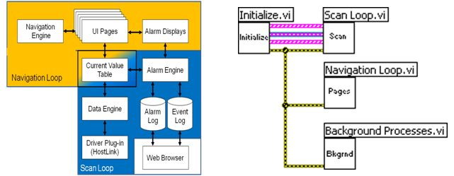

First I understand the general answer to programming an TPC HMI is no or not much different than a desktop.   I cam across the Simple Machine Control Reference Application,   http://www.ni.com/example/31250/en/#toc3.
I have looked through a few of the white papers related to HMI developement, many of which seem to be based on 2009 programming techniques / Libs
I understand the image below is a good technique to follow for a HMI application
I have been unable to find other reference applications other than the Simple Machine Control Refereence

1.  Is this still a relivant application scheme under 2014?
2.  What has replaced the HNE Lib?
3.  The ref example uses a single VI per HMI page, not a bad technique but NI support group has mentioned the use of Tab Pages, I can work with either, just would like to see if anyone with recent experience can shed some light on the topic.
4. Does anyone have a recent example using the before mentioned libraies OR another technique that can be shared?

After reading the whitepaper you mentioned (Simple Machine Control Reference Application) can verify that this example can be implemented on LabVIEW 2014, obviously the toolkits and respective drivers have to be compatible con LabVIEW 2014, but the core of the example can still be implemented. The HMI Navigation Engine (HNE) Reference Library hasn't been updated in a while, so you can still use the same link provided in the above mentioned whitepaper.
Regarding the use of a single VI per HMI page vs. the use of tabs, would not be able to provide a good recommendation here since it's not something I'm that familiar with, although I can say that if you already found a forum with expert users recommending the use of tabs, then it's fair to say that would be the way to go.
