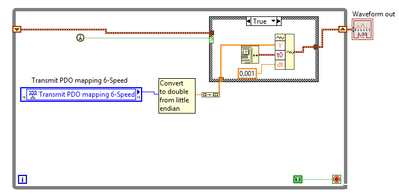

Good Morning,
I'm new to labview. I can't figure out whats the best way for memory efficiency of building a waveform which is then displayed (using a notifier) and logged (using a queue). I'm getting single read from ethercat slave in a loop. You can see in the attached file what I'm trying to do ( I know it is not a good way but as I said I can't figure how to do it).

thank you for fast response. Maybe I didn't explain myself good. All you write I already know. What I would like to know is how to build and array/waveform which keeps increasing in each iteration loop. From each iteration loop I get one "double value" which I need to insert into the array/waveform.

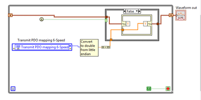

I can't find the loop you mentioned. Here is my best try I found it is good for saving into a TDMS file. For displaying probably I will need to append point to a waveform of fixed size in the host computer as now it is a waveform of a single point.
