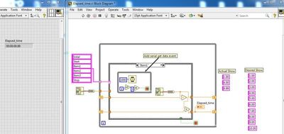

   In my code I want to add elapsed time in while loop,how to show time smoothly as sequence. Here is snapshot and comment,for you refer,thanks!

You are only updating your elapsed time indicator when you state changes which is why it jumps so many seconds.
You need to put your elapsed time logic in a separate loop which is triggered to stop when your main processing loop stops.
I have attached a possibility.
As an aside, Rather than using strings for your states, you are much better off creating a enum type def which contains all of your possible states. This removes any possibility of typos, and if you change the elements in your enum your case structure will automatically update or give you an error at compile time rather than a runtime error.

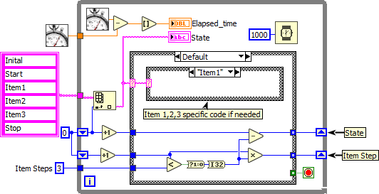

See if this can give you some ideas.
Note: No inner loops! No local variables
Second Note: You could just connect your elapsed time to the iteration terminal. Same difference. Above code is more flexible, because you might want to change timing in the future.

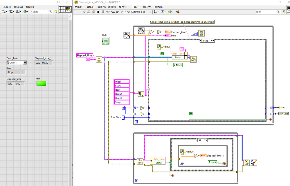

Yours comment are very useful, I have changed queue instruct show tick time.Any thing else to change,thanks for us help me for the issue.

Wow, now you are way overcomplicating things again with inner loops, local variables, and queues.
All you probably need is half the code!
