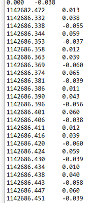

here's one that does it.  this works fast, though.  here is, also, a screen shot showing how it doesn't start at 0 sec.  By, the way, thanks for replying so fast!!
notice that at third point, it jumps from 1142682.472 to 1142686.332.  i asked for 4seconds and got far less than one second.
