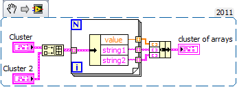

Unfortunately that didn't solve my problem.
I would like to get something like this (picture) in the end where the number of input clusters would be variable.

whenever you need to handle several objects of the same datatype you should build an array of them:
Isn't there a built in function for that nowadays? (since 2014 or something)

Index and bundle exists!  I would caution the OP to use a variant rather than a string.
