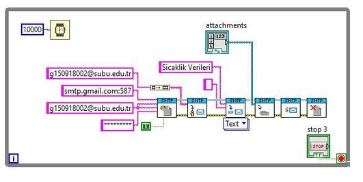

Ekran Alıntısı.JPGHow can ı send e-mail like this at hourly not every 60 minutes for example 1:00,2:00 or 16:00

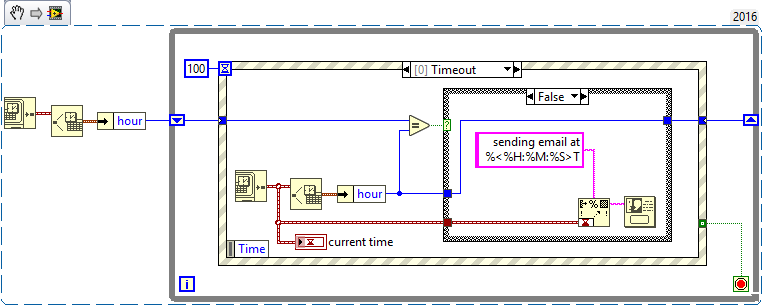

You could check what hour it is and send the email whenever the hour changes from last time you checked.
