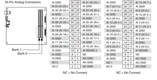

Recently, I have acquired an Usb-6343 device and now I'm trying to hook this up with the Emg sensors I've been using. I'm not sure if the sensors arecompatible with the Usb device or not, but I would really appreciate it if anybody who knows how to set up the system would kindly help me out. So my goal would be reading

You should be able to read the voltage output of the EMG sensor with your DAQ device.
You will need to provide it with an external 3.3-5.5VDC voltage though. A benchtop power supply would be fine.
I am currently struggling to find a manual for this device, but from what I have found you might need connectors to wire signals to the 6343.
To connect your EMG sensor you will need to make the following connections:
EMG Sensor               6343
AO Pin 1                     AI0+ Pin 11
0V Pin 3                      AI0- Pin12
0V Pin 3                      AI GND              This may or may not be necessary/ you might need a bias resistor here to reduce noise.
Double check with your actual device to make sure that I have got the right pinouts.
This will allow you to take differential measurements of your sensor
Actually taking the measurements you can either use MAX (Go to your device and press create task) or using LabVIEW to create your own program.
If you are going to do the latter I suggest having a read of how to use the DAQmx functions.

Thank you so much for helping me out. Taking your advice, I've managed to figure out how to
set up the system. Also, the website on how to use DaQmx functions was also very helpful:)
