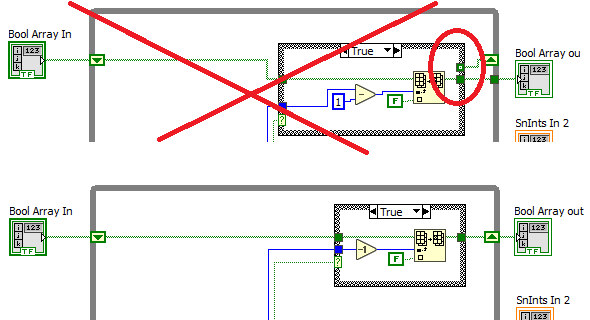

In your subVI, you a setting the boolean array in the shift register to an empty array as soon as the timer has not elapsed, i.e. instantly.
Eliminate the "use default if unwired" output tunnel and use the other tunnel to go back to the shift register. Wire the output terminal to the outside of the shift register.

Depending on what else is going on, you could also just eliminate the shift register, of course. You don't really need it here.)
My earlier explanation graphically explained:

Altenbach, I think this is going to work my shining Knight of NI.
I'm going to make these changes to my subVIs and test it out. But in the meantime something that confuses my is this "use default if not wired" option. In my mind that means if a particular tunnel of a case structure is not wired for the given case, that whichever is the default case, that tunnel's value is used. In my example the default is False (I believe?) and in my false case I simply pass through the boolean array unchanged. Would this not be what the true tunnel sends out? Why is it empty at that stage?

Me putting the unchanged variables into the subVI was me desperately trying to find the solution thinking that all data into the parentSubVI had to flow into the child too or else it would be asynchronous. Obviously that is not the case I just had a misunderstanding of the very basic premise of the Use Default if Unwired class haha. I now know that refers to default data, not default case.
The solution worked and you've been a great help!
