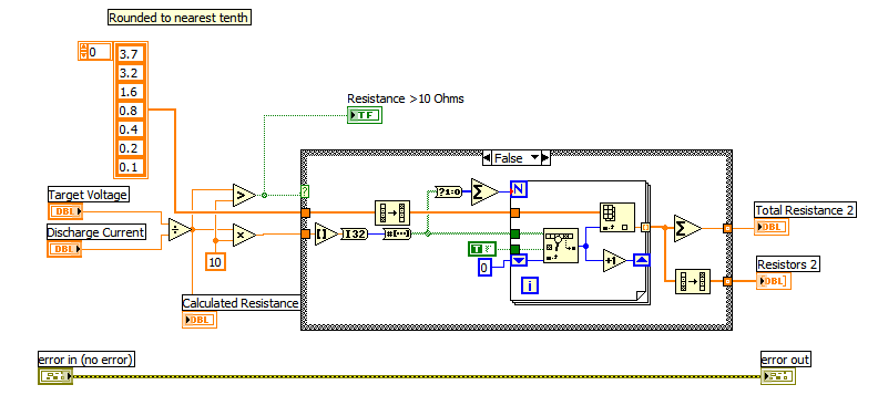

Some of your code is very Rube Goldberg'ish:
If you want to operate with one significant decimal digits, multiply everything by 10 and work entirely with blue integers inside the loop. Divide by 10 after the loop.
You should use an autoindexing FOR loop and stop if the resistance match (Just show the conditional terminal).
Message Edited by altenbach on 06-30-2008 11:15 AM

Here's a simple alternative, assuming you want one decimal digit.
Also: A math loop should NOT have a wait!
Message Edited by altenbach on 06-30-2008 11:31 AM

I have not tested this extensively, but would the following work as well? (Note that I did not put in the check for >10. Also, since I have 8.2 I don't have the conditional stop on the for-loop. Smiley Sad)
Message Edited by smercurio_fc on 06-30-2008 01:32 PM

Ah, yes. I did not notice the x2 pattern in the resitors.
In this case, things are even simpler!
Modify as needed.
Message Edited by altenbach on 06-30-2008 11:51 AM
Message 19 of 22
(1,447 Views)
Oops, altenbach, that won't work. 3.7 is not in the x2 sequence. For the values V=150 and I=16 the calculated resistance is 9.375. Your latest VI gives resistor values of 3.7, 1.6, 0.8, 0.4, and 0.2, for a total of 6.7. The correct resistor values should be 3.7, 3.7, 1.6, and 0.4 for a total resistance of 9.4 (rounded to nearest 0.1).
