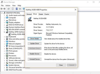

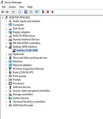

1. I don't see Keithley 2400 in my Windows Device Manager but I can see the Keithley GPIB card. The driver information of the KUSB-488B card doesn't show version 3.13. It showed as 7.0.2.1117. Here are the scrren shots.

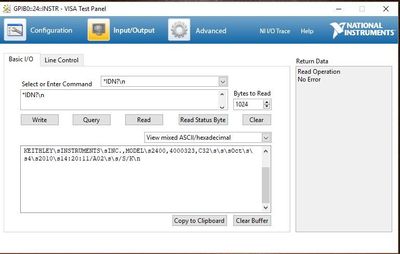

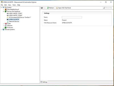

2. NI Max can recognize the GPIB card and VISA Test Panel was able to communicate with 2400 with no errors. NI MAX.JPG

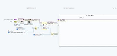

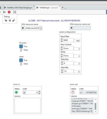

The driver for 2017SP1 works with no error (both Read Single.vi and Initialize.vi). The Pluag and Play driver for NXG (both Read Single.gvi and Initialize.gvi) doesn't work showing the same error code as before. I opened initialize.gvi and here is what I found. Error our showed a code
'd -1073807202' with a source '<2>{"desc":"","chain":["NI:VISA: Set Error Code.gvi:520001","NI:VISA: Open.gvi:2160001","NI:VISA: Open (Instr).gvi:2340001","Keithley 24XX: Initialize.gvi"]}'. When I checked the Diagram and slow the execution, I found that the error started at the first call which is VISA Open.initialize gvi error 1.JPG
I then opened VISA Open and run it. Here is the error out message. 'd -1073807343' and source '<2>{"desc":"","chain":["NI:VISA: Set Error Code.gvi:520001","NI:VISA: Open.gvi:2160001","NI:VISA: Open (Instr).gvi"]}'. I didn't take scrrenshots this time.
