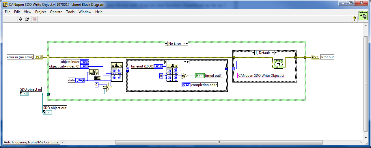

My issue is I'm running three identical motors from three different PCs using identical code. Two of the rigs are rock solid but the third intermittently (i.e. about very 20 minutes or so of operation) will throw an Error 1097 and LabVIEW will crash and have to be restarted.
The image attach is the block diagram of the vi - as its NI code I can't actually edit or modify it (or even connect the error wires which I'm sure would perhaps prevent a complete crash). I've seen multiple Error 1097's mentioned and the solution seems to be to fix the dll caller - something I can't seem to do here.
Has anyone come across a problem with this particular library before? My instinct is to do a complete clean and reinstall of the troublesome rig but I'd like to keep this as a last resort.

Error 1097 is almost always an error in configuring the Call Library Node right. So I am afraid the error has nothing to do with CANopen Library. The reason that it sometimes works and other times not, is in fact that it never really works, but sometimes the error that gets caused can not be detected by the OS and LabVIEW does not get an according exception. This can change depending on LabVIEW version, runtime or development system and even recompilation of the code after small seemingly unrelated changes to the application.
NI CANopen LabVIEW Library was end of life already. NI recommends the PXI-8531 or NI-9881, and NI-Industrial Communications for CANopen now.
