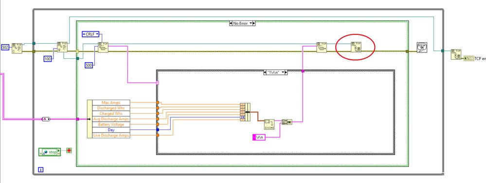

Negative, in the screenshots I provided earlier it shows that I did not wire the listener id to the connection id, which would be incorrect.

Accepted by topic author David99999
I believe I've got the issue resolved. Somebody on Reddit came to the rescue. See their response below:
You should be laying out your code a bit differently. I suspect you're running out of ports or something for the client connection since it's reconnecting for every transfer but old sockets aren't getting cleaned up properly (I'll add more once I'm actually at my pc)
Edit: Okay the easy answer with the code you have already is to make sure you're closing the client TCP ref after you do the write. You just let it float away into the ether and LabVIEW is likely never releasing the client port that it used for the connection. You're either bumping up against a TCP reference limit or it's run out of available port #s it can use to establish a new connection request. The client TCP ref is separate from the listener and you're only closing the listener reference when you want to shutdown.
What I did was placed a TCP close connection in the server loop, circled in red in the picture below.
Message 14 of 14
