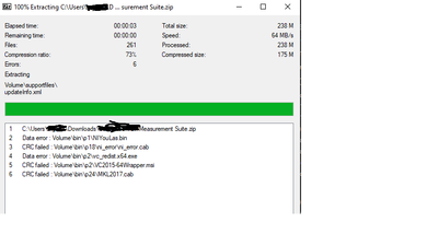

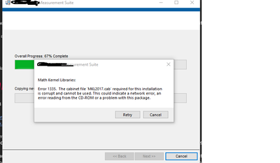

"When unzipping the file I get 6 errors on various cab files, vc_redist.x64.exe gets blocked by Security protocols. And if I continue with the install, I get errors from cab files being corrupted."

Maybe it's for security reason but why do you need to zip it?
What happens when you are doing the unzipping on your computer?
Have you tried to redo the whole process : build => zip => unzip => install ?

My guess is the installer ended up being larger than the USB stick, but if it was, you should've gotten an error on copying it to the stick, or an error in the install build if you tried to build it directly to the stick.  Installers can get pretty big, especially if you are pulling in a lot of drivers.

I built the same package but did not zip it and received a new error during installation.
The "NI Microsoft Visual C++ 2015 Run-Time x86" installation has failed with return code: 16389.
and
The "NI Microsoft Visual C++ 2015 Run-Time x64" installation has failed with return code: 16389.
