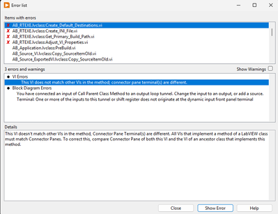

After closing LabVIEW, I opened up the AB_RTEXE.lvclass file and found a few errors:
These VIs are protected, so I can't dig into them to fix whatever happened. I had performed a repair in NIPM of "LabVIEW Runtime (32- and 64-bit) 2024 Q3 Patch 2" but the problem persists. This problem seems to happen on two computers (project is shared over OneDrive) with the same version LabVIEW installations, which is very weird to me.
Any advice on how to proceed? Is there a way to fix the broken files? Thanks!

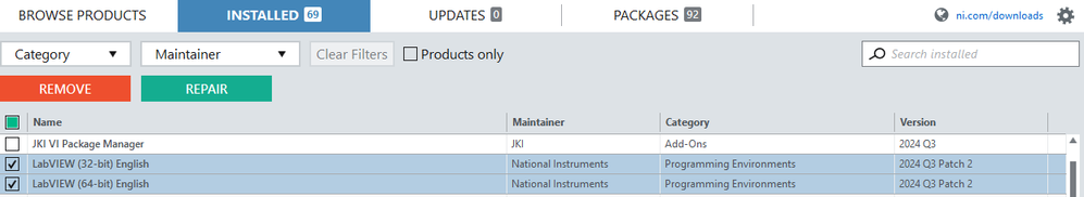

The issue is in the development environment so you'd need to repair "LabVIEW" not just "LabVIEW Runtime"

After a lot of trying, the error still persists. What I've done:
  • Performed repair on just the above mentioned packages. Asked to reboot, no luck.
  • Performed repair on all packages, about 30 packages will not repair after two attempts.
  • Tried uninstalling and reinstalling since packages would not repair, same error.
  • Performed repair on just the above mentioned packages. Asked to reboot, no luck again.
It seems like there's a problem installing LabVIEW since this persisted after a new install. This happens with multiple separate projects involving a RT build spec, so it doesn't seem project specific.
