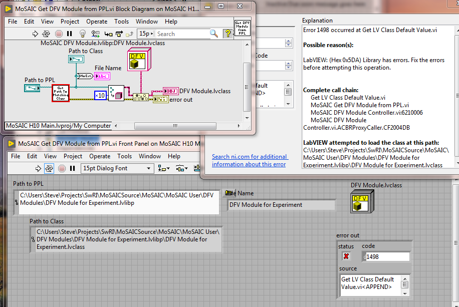

For reasons unknown, I am now getting an Error 1498 at GET LV CLASS DEFAULT VALUE.
I am dynamically loading a PPL containing a class, and trying to extract the class and use it.
Some change to the class has apparently triggered this new behavior but the error message is useless.
This happens in the DevSys as well as in a built app.
The weird thing is, if I hit the breakpoint above and step thru, I see the error appear.  If I quit the main program and then run this VI by itself (using the exact same path), it succeeds without error.  Therefore the error is sensitive to context - but what ?
How do I debug this?

It's got something to do with a context that I don't understand.
Now EVERY grandchild shows the same behavior: 1498 when trying to GET DEFAULT CLASS and the main host is BROKEN after quitting.
I now have an instance of the PARENT class in the main host.  No good.
There's a key in the fact that, running from the host, the 1498 occurs, but yet after I quit the host and run that same subVI by itself, with the same path coming in, it succeeds.
But I can't see what the key is telling me, and the error message is useless "There are errors in the library" ? ? seriously?
