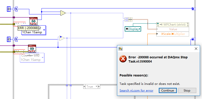

Do you mean where it is gone wrong when running? As follows?

Hi hblin,
Kind of…
From your image it seems the error is generated before the DAQmxRead function.
You need to debug earlier upstream the DATAFLOW!

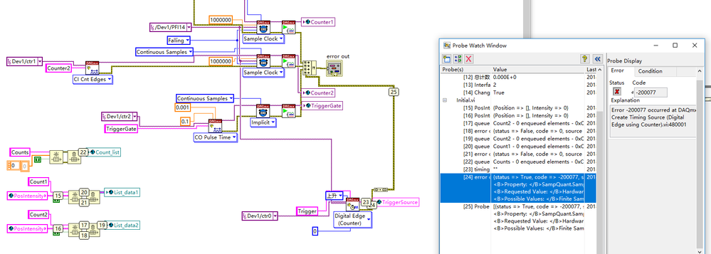

Actually that is showing a different error number now.

I'm sorry, I don't know much about LabVIEW debugging. But, do you mean this?
Message 15 of 18
(1,404 Views)
I pressed the "continue" button and then pressed the "Pause" button, which shows the error.
Message 16 of 18
(1,404 Views)
Hi hblin,
so that DigitalCounter(Edge) is not supported by your hardware (or the combination with those other tasks).
What do you want to achieve with this DAQmx task?

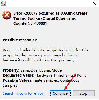

This error is occurring because:
1. USB multifunction I/O devices do not support hardware timed single point acquisition
2. Only PCI/PXI/PCIe/PXIe DAQ devices can support Hardware-Timed Single Point Sample Mode (HWTSP).
For a complete list of supported and unsupported device, please refer to our documentation:
http://www.ni.com/product-documentation/54449/en/#toc4
In HWTSP, samples are acquired or generated continuously using hardware timing without a buffer. Because samples must be continuously acquired/updated and processed on a point-by-point basis, you need to use a fast, deterministic bus. The inherent latency of the USB bus itself does not provide enough determinism to allow this output mode, therefore it is not supported.
