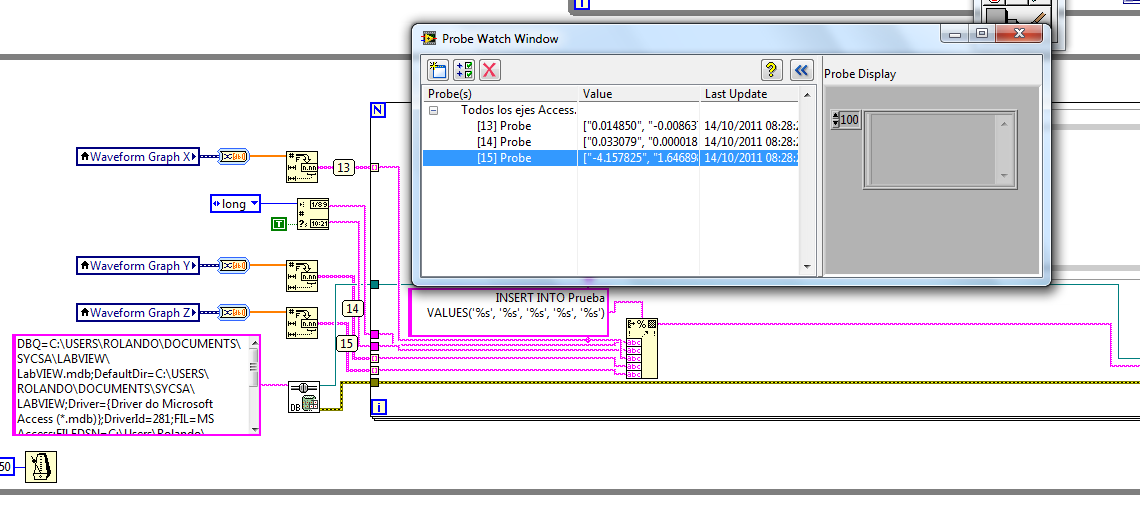

Hi Rolando
I was looking your problem and I think you have a problem wtih some arrays in the while loop with th foor loop. Tha maximum numer of elements that you can introduce to an array es 2,147,483,647 elements. So thas maybe the reason of your error. You can verify this placing a Probe to check the number of elemnts. To do it go to the View>> Tools Palette, there tou can select the tool Probe and place it before de for loop. Then you run your VI. If this is the case you maybe want to implement a circular bufer.

Thanks Julio
I used the probe tool until it gave me the same error, then i check the size of the array and it was the same as the number of samples
So what you think is happening??
