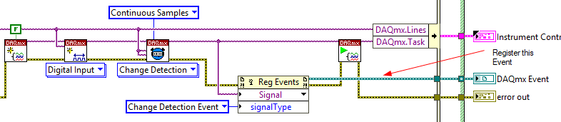

For the Change Detection Event you would have to do something like the following:
and then register the dynamic event in your event structure. I am not sure of your skill level, so maybe there is a better/easier way, but this is how I would approach the problem.
