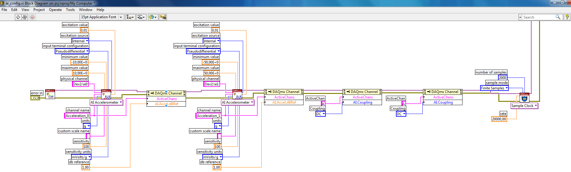

Error -200431 occurred at DAQmx Create Channel (AI-Acceleration-Accelerometer).vi
I tried to use DAQmx Create Channel for Accelerometer yet  it respond with error (below). When i use NI max to measure accelerometer (AI-Acceleration-Accelerometer) , there is no error and i can see that acceloremeter works .
NI PXI 1042 and i use NI -4462 card to measure vibration vith acceloremeter.
Error -200431 occurred at DAQmx Create Virtual Channel
Possible reason(s):
Selected physical channel does not support the measurement type required by the virtual channel you are creating.
Create a channel of a measurement type that is supported by the physical channel, or select a physical channel that supports the measurement type.
Property: AI.MeasType
Requested Value:
You Can Select: Voltage, Sound Pressure:Microphone, Accelerometer, Position:Eddy Current Proximity Probe, Force:IEPE Sensor, Velocity:IEPE Sensor
Task Name: _unnamedTask<104>

Hi Julian,
When i use acceleration mode, i get error from DAQmx Clear Task.vi( DAQmx Clear Task is the last component of my program. If the last component is DAQmx Stop Task, i'll get error from that. And if i use error indicator, program will work yet it always show that there is error !!!)
i use "Voltage - Continuous Input.vi" example that you suggested, it works with 4462 card.
Is acceleration mode not compatible with ICP type accelerometer. Should i use only voltage input option for sensor??
