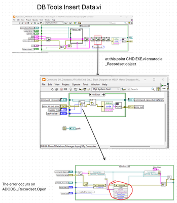

I developed an application on LV 2020 32 bit that uses the Database Connectivity Toolkit.
It was working fine with Windows 10.
Now with windows 11, it is giving an error when inserting data into the database.

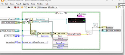

I was able to find the point where the error occurs. This error happens on the LabVIEW library
Anyone has faced this issue ? Any help is appreciated.
I'm not sharing my code since the issue happens on the LabVIEW libraries.
C:\Program Files (x86)\National Instruments\LabVIEW 2020\vi.lib\addons\database\Recordset.llb\Rec Create - Command.vi

the error happens on the NI library vi, and also happens when running the example shipped NI Database toolkit.
If i was to try implement option number 2, do you happen to know any reference for this implementation on windows 11 (about the string) ? If that's the case then the NI libraries  will need to be modified.

When creating the object  ADODB._Recordset.Open - source is wired to ADODB._Command that's when the error happens.
It worked fine with Windows 10, this is LV 2020 (32Bit), SQL Server Native Clienc 11.0
I wonder if anything got lost with new versions.
