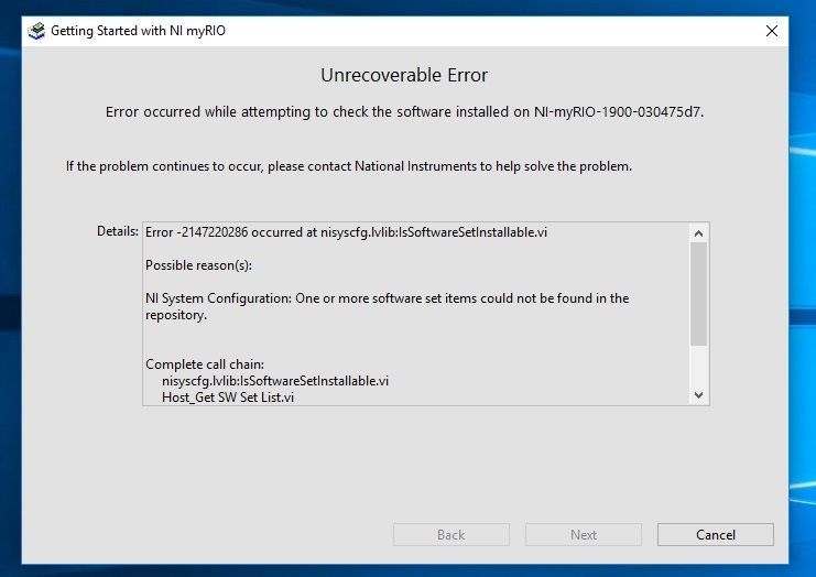

Error - 2147220286 /Getting started with myRio
Aftr installing all the drivers+ mainly LabView 2019 i connect the MyRio 1900 -> Getting started Wizard and...myRio.jpg
In total i wasted 4 Hrs for installing and 22 Hrs for solving the Errors and Bugs ,this one beated me up.
If smbd has any idea , please give me 1 min of your time and write me. Thanks.

I'm not sure what cause the problem but I found following article.
LabVIEW 2013 myRIO Module f1 Patch Details
Your problem is similar to the article. Do you remember whether you have installed it?
(Of course I understand that you don't install LabVIEW 2013...)

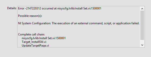

I was almost to celebrate... It really solved the error but now appeared a new one
U still have some more advices? Thx
(3,146 Views)
Have you already read this article?
Error -2147220312 When Updating myRIO Software
Wasn't helpful?
