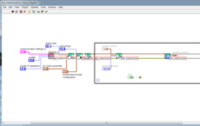

I`m programming Maxon motor controlling with EPOS 4 position controller via LabView.
However, during basic programming, this error has occurred.
(On the block diagram it appeared as ERR268343459 and "Handle is not valid 0x10000003 in error out box of front pannel)
Program is not stopped by this error, but error is occurred at "Initial" block and keep going to next block.
Of course motor was not actuated.
How can I solve this problem?

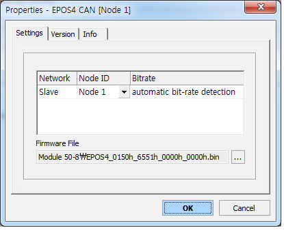

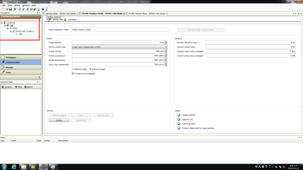

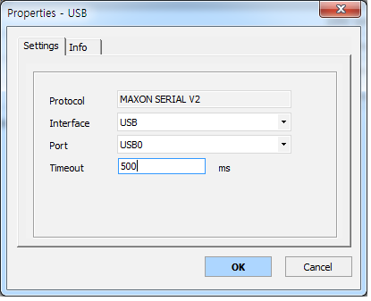

As your advice, I turned EPOS4 Studio on and confirmed the connection.
That was like below.
Red square shows device information on EPOS4 studio.
These windows are property of my device. With these communication setting, I could actuate my motor on EPOS4 studio.
(Interface, port and NodeID has the only one option - USB, USB0, Node 1)

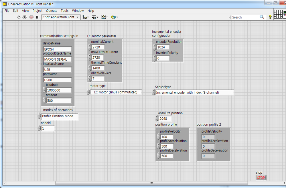

And finally this is my labview monitor. Unfortunately, with same communication settings as EPOS4 studio, same error is still occurring.
