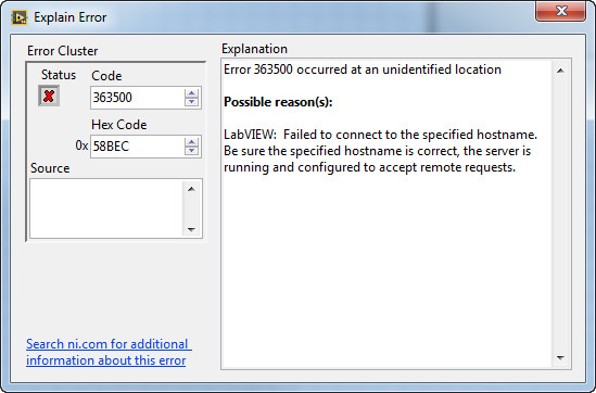

I am trying to do WEBDAV file transfer from my RT Target i.e PXIe8135 to my host PC with LabVIEW 2014 SP1.
In this process I'm getting this LabVIEW error 363500- Failed to connect to the specified hostname.
I have also tried with the Example VI on Webdav Data Acquisition but getting the same error.
Perhaps, there is some communication gap between my Host PC and the RT- PXI.
Please kindly help me to troubleshoot this communication problem and thereby solve this error.

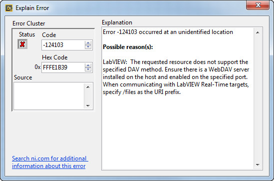

Hi Anna,
Earlier, few months ago, Webdav was running without any problems even though I had not followed these above mentioned steps.
I had just opened the Webdav data acquisition sample project and had given the Host Uri Prefix in the form http://<Target IP Address>/files, username and password. This sample Webdav project had executed perfectly.
But now, I have moved into another network and have different IP addresses both for my Host PC and Target PXI.
And I am trying to transfer files just the way I did before but getting some errors.
Now I am getting this famous Webdav error 124103.
So, do I need to unconditionally follow these Webdav configuring steps or there is something else that I am missing?
