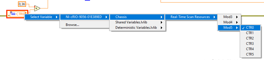

Error -66208 shared variable. Reading data from the encoder (NI-9411).
Hello.
Error -66208 - Shared Variable in EncoderRT.vi->RT main.vi<APPEND>
This error or warning occurred while reading the following Shared Variable:
\\NI-cRIO-9056-01E389ED\Mod5\CTR0
\\192.168.255.4\Mod5\CTR0
An error occurs when reading data from a variable CTR0.

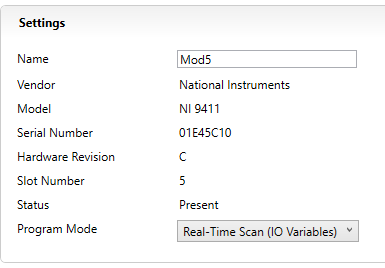

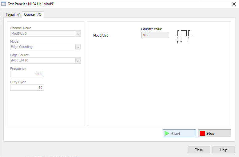

In other modules, analog and digital signals are read and written correctly. Restarted the service (NI Variable Engine).
What could be the reason for the error?
Thanks.
Block diagram.PNGMAX - Settings.pngMAX - Test Panels.pngModule Properties.png

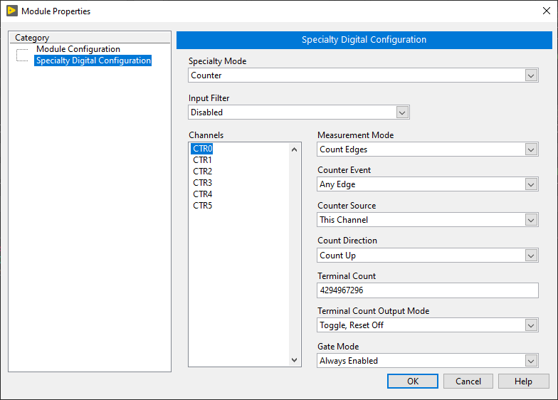

I found out that error -66208 is "Invalid variable refnum. Either the variable was deleted after the reference was opened or a valid reference was never opened."
There are few reasons for this error to occur:
1. The module is not connected properly.
2. The variable did not match up in the Distributed System Manager as the user-defined has been modified
Please try out the following to see if it helps:
1. Reinsert the module
2. Create another variable
3. Use another channel
Hopefully this might help you.
