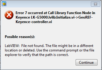

I am having some issues with LabVIEW creating a working executable for my application. The program communicates with a Keyence LK-G5000 series laser displacement sensor with drivers provided by Keyence. When running the program within the development environment, the program runs without any issues. However, when building the program and running the program with an executable, the program outputs Error 7 as shown below:

Executables take different path, as a start of debug make the path as indicator and see what path is being expected in executable mode?

It looks like I was missing a another strip path on the development environment after using indicators to show the DLL path.
The problem is now solved.
