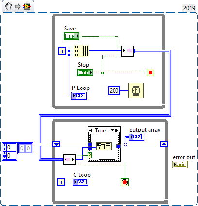

Found a demo I wrote showing a (very simple) Producer/Consumer using Streams.  Producer generates array of three increasing numbers, passes them to Consumer which assembles them in a larger array.  Consider Consumer being a Chart ...
If "Save" is True, data are "saved" by being sent to Producer.  "Stop" stops both loops.  Note the funny rectangular things with a Blue Pipe at one end a an Integer Array at the other are Channel Writers and Readers of Integer Arrays.
