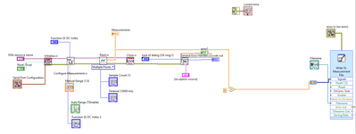

here is the diagram.
I'm connecting the agilent using the port COM6, and nothing else is trying to access the resource.
I'm using labview 2019, and the last version of VISA.
Message 3 of 9
(5,466 Views)
Serial ports can only be accessed by one process. From your screen shot it looks like MAX (Measurement and Automation explorer) is open, are you trying to communicate with the com port there?
Other things to check is that those sub VI's are not trying to open the com port more than once. You could probe the error wires at different spots to see where exactly where the error is coming from. If it's between the Agilent(maybe?) open and the other sub VI something else already has control of the com port. If there's no error there, but there is after the second VI then you are probably trying to open the com port twice (the first time taking control, and the second time getting an error when trying to take control again).

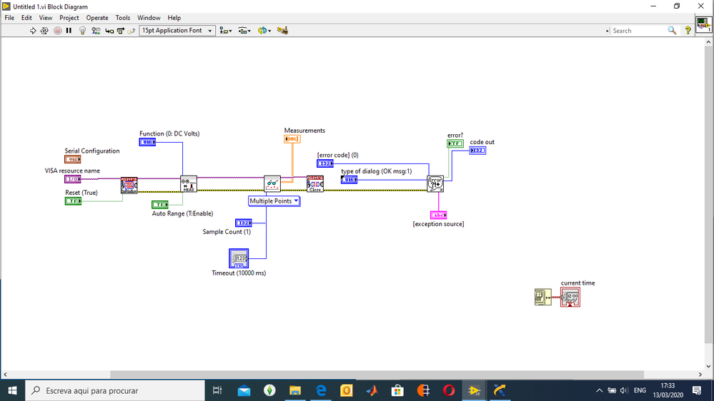

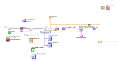

Hi!
Thanks for your help.
Now i have another of error : -1074000000 , what is that?
See the following pictures. Where am i doing wrong?
Every element of the VI is configured to the same COM PORT.
Message 7 of 9
(5,260 Views)

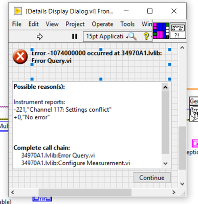

You are now getting an error from the instrument.  So you are actually talking to your instrument now.  But there is something wrong with how you are setting up channel 117.

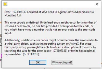

Now, i`m getting this error:
Sorry for disturbing you.
