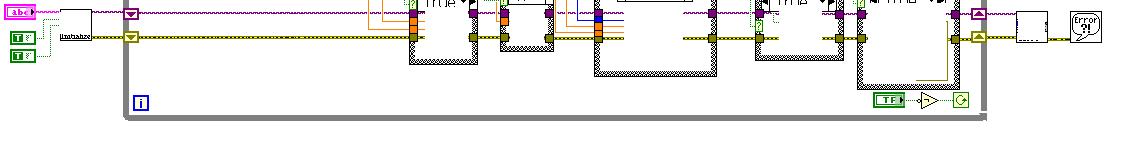

I have not understand if it's good or no to pass error in and error out in shift register when it's set a instrumentation in loop. For example in this figure there is this, but many persons tell me that it's dangerous. Why? What is the better way for an exeper LabVIEW programmer?

Everyone has their own philosphy on this, but I do not typically use a shift register.  My personal style is that each cycle of the loop should start "clean".  If there is an error before the loop starts, I don't start the loop.  At the end of each cylcle of the loop I place my Error Handler.   This error handler decides if the error is fatal and should stop the VI, or in most cases just resets the instrument in question.  After handling (and logging) the error, I reset the error out to no error and start the next cycle.  Whether or not a shift register is used, the cycle starts with no error.
My error handler contains a feedback node and I usually consider two consecutive errors to be fatal (this often means time for a power cycle).
If you use a shift register and never handle or clear your errors you often wind up in an inifinite loop which spins as fast as the CPU allows.  In short, whether or not you use a shift register you need to decide (as early as possible) what you want to do in the case of an error and how you intend to handle it.

For me, using the shift register is often very important for error trapping.  Without the shift register, it is very easy to lose the error information.  When you do use the shift register though, you need to make sure that all your subvi have a case structure that case the subvi to not execute but only to feed through the error information.  By doing that, when an error occur, it is just going to feed through all the vi and loop iteration without being corrupted.  If you trap the error, you will be able to trace back to where your bug is in your code.

Why would you want to have a while loop continue to run if you aren't going to do nothing in later iterations of the while loop?  You might as well just go ahead and stop the while loop as soon as you get the error.
What could be worse is that the while loop might never end because of the error which would happen if the while loop would normally end based on something that would occur in the loop in the No Error case of your while loop.
I'd say the only way a shift register on the error wire is a good idea is if you have the NoError/Error case structure inside your loop, and you explicitly do something with that Error in the Error case on the next iteration such as closing/reopening your resource, or logging the error to a file, or triggering off some other process, and the proceed to clear the error so that your while loop goes back to normal operation.
